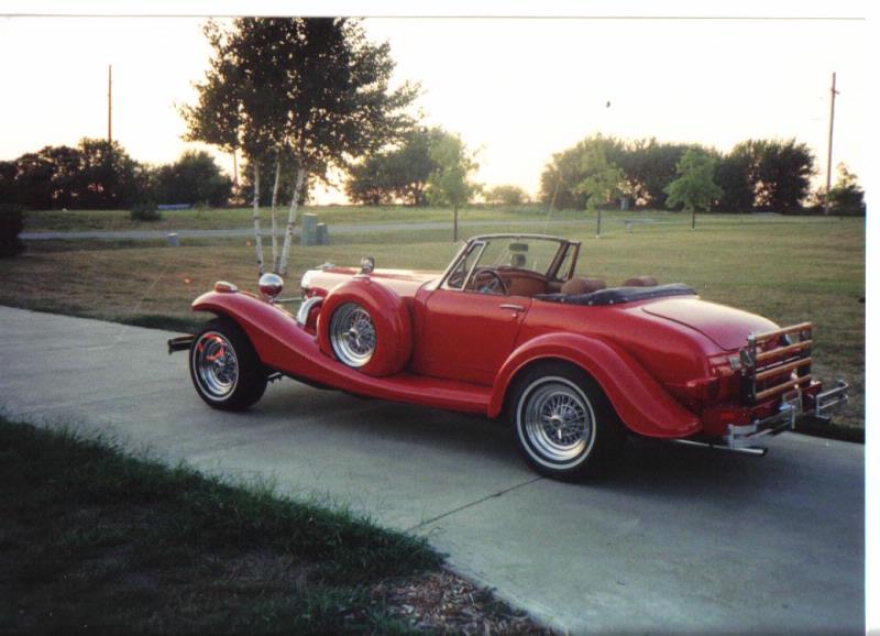

Rustyr,...That is a real net project. I have something different. It is a car I built trying to replicate an Excalibur. I planned it for several years intending to use a Chevy Nova stub frame & power train, M body and a grill from a late 30s International truck. I spotted the International along I35 near Perry, Oklahoma. I found a 78 Excalibur & got the drill, radiator & spare tire covers. A car builder in California built some cars with the Midget body, Lincoln Cont grill & T Bird frame. I got the frame plans from him & used a Mercury Cougar.

It was a lot more work than building a sprint car. I always liked the Excalibur after they came out with the 80 model with the long front fenders. You could call this my, Poor Man's Excalibur. It had parts from something like 12 different cars. A 1976 MG Midget body (from the KCMO Police salvage yard), 89 Mercury Cougar frame, 76 Chevy Nova 305 with automatic trns, 81 Excalibur front fenders, 36 Ford pickup rear fenders (from a fiberglass shop in Beloit, KS) , 76 Olds Tornado tele-tilt steering, wiring harness from the Nova & Tornado meshed together so the ignition switch starter would work. I went to the local library, copied diagrams of both wiring systems, drew my own set for the car then rewired the harness. It worked. A Ford Model A luggage rack from J C Whitney. I made the hood, side panels , front & rear bumpers & dash. The dash was walnut from a cabinet shop cut out to fit. I removed the MG rear taiights & welded in 3" flex tubing. Finished in fiberglass. The tailights are Olds Cutlass teardrop side mirrors with boat trailer lights molded in. Front fender lights are VW. I also made the headlight bar. The hood has a hinge down the middle from a horse trailer door. I used a power brake unit from a Ford Fairlane as it was the only one small enough to clear under the hood.
I lived in Olathe (I was PM there from 1980 until I retired in 1998) when I built the car. I finished it & titled it in Jan 1991.

Rustyrail, You were right on the fenders. They were made in Mankato.....It was a lot of work. I had to mount the radiator first as low as I could set it, then line the body with the frame & top of the cowl to the top of the radiator. I mounted the engine & trans first as they were set back 12 inches from the Couger mounts. Everything I did caused something else to change. I had to cut the bottom coil off the front springs. The frame stuck out back of the body about 10 inches so I made a cover for then added a luggage rack to balance that area. I even cut the side rails out of the frame (the part that bows out) & replaced that with 3 X 5 tubing ..It was worth it as the car came out like I planned.....Luther
