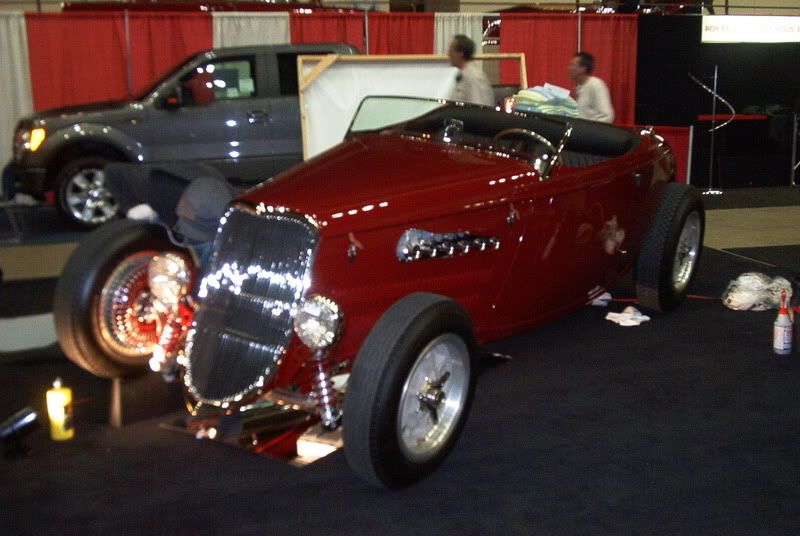

The dirt track influence and Indy influence has been making it's rounds through the high-end rod shops for years, these days it seems they are in bloom-
Based on the Barney Oldfield racer from early last century,
DSC_0114.jpg picture by brian26_photos_2007

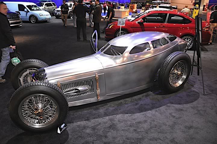

Picturesf09025.jpg picture by brian26_photos_2007

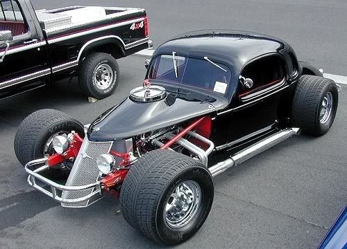

041345-vi-1.jpg picture by brian26_photos_2007

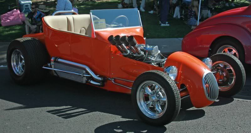

TrackT.jpg picture by brian26_photos_2007

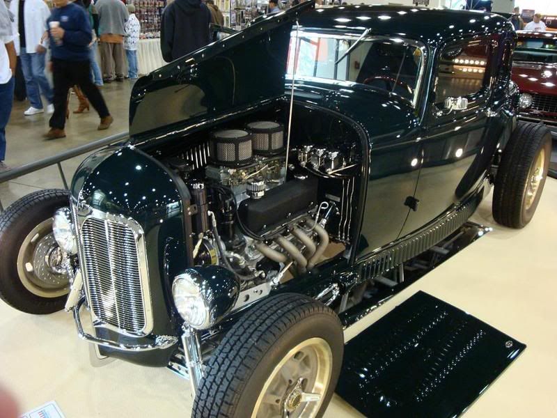

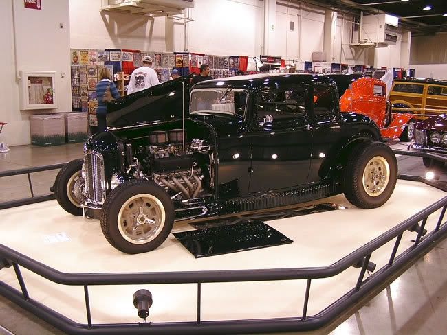

Our own Jackie Howerton has been working on this car for around 17 years,
jackiehowertonswork.jpg picture by brian26_photos_2007
February 27, 2009 at 11:08:46 PM
Posts: 7918
jackhowerton.jpg picture by brian26_photos_2007
