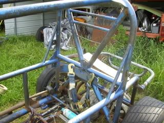

Anybody remember a George Stephens? This car is VERY much like the one I'm working on. Just curious.
Pitman arm placement is the same, both were set up for 6 cylinder at one time, even the rear wheels set back about the same at one time.
Brian,
This is a Walker car, Aaron had them build it, the torsion tubes were under the seat and the arms ran back to the shackle plates, Aaron ran this afew times and Grady Wade drove it also for Aaron, I also believe this is the first car that Larry Madden drove. Somewhere in this thread you have posted a pic of this car that has Larry's name on it. Jim would know alot about this car it was in the time he worked for Aaron. George bought this car and put the 6 cyl. in it and was pretty fast at OKC & Goldsby. I remember he won 2 or 3 A-Fea. in it during this time at OKC, I believe it worked real well on the dry slick.

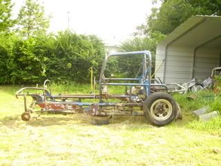

This the best picture I have of it not long after it came here. Metallic blue frame, pitman arm location, 6 cylinder setup, all the same.
Brian,
I thing the car in the back ground might have been Gary Cole's #35 it had rear cross torsion, of course somebody could have put rear cross torsion on the #01 also. Gary had a 6 cyl. modified that was blue frame with a light blue body and dark blue and yellow strips, it had a thin alum. full motor plate and when he ran it it had an Allison built Power Glide with open drive line. Had a schroder 6-1 manual steering.

Gary Cole. I'm sure it's at least a copy of a Walker, but not the real thing. Ours is NOT the Madden car if the torsion tubes ran that way.
Did someone turn out a lot of Walker copies back in the 70's? I keep running across a lot of them relatively speaking. Reason I ask is this tubing does not look like moly or DOM. More like pipe to me. Yet the welds look like someone spent a lot of time doing this type of work with a mig since they are more consistent than your average backyard builder.

Brian,
That is another reason I think it is possible Gary's car I remember it being built out of non-std. tubing. Also as you know a ton of people were building there own cars back then and alot of them looked like copies of Walkers. B&T built a few cars and did alot of repair work, the first few cars they built were alot like Walker cars and then they hit there own stride and had there own designs.

My son told me about this site and I decided to look at the car in background. The reply was fairly accurate about my car except my cars had auto transmissions built by Gene Brown from Norman. Gene, along with Ken Hailey and Lee Martin owned the #54 modified that ran @ OKC and Lawton. Arley Anderson from Norman built an adapter to replace the torque converter. His early ones used the end of a Chevy crankshaft so as to bolt up to the motor and the rest was tubing with notches to engage tangs in transmission pump and drive gear with splines inside the adapter. He also ran lines outside from servo valve to ball valve. You could start the motor in gear and it would not move. You opened the valve and it was like releasing a clutch and the car moved. If this is my old car, the chassis was built by Phil Hancock of OKC. Phil drove the orange #12 modified
and built several frames for people. He worked for a mechanical engineering firm in OKC and was an excellent welder. The
material was not moly, but black pipe. Les Lusk of OKC also built several of these chassis's. There were not too many moly frames then on modifieds or supers. Some were better than others. I have picture of this car that I will post after I won a feature in Lawton. You might look at one of the recent postins about a site that somebody found that has pictures from OKC, Tulsa and Enid. Click on Tulsa and there are pictures of Emmit in the #52, Benny in the Suchy car, Darrel Brazeal and me in the #35. My picture was of me packing the track in the opposite direction. This was a qualifying day for NCRA on Memorial day weekend, Qualified in the day and raced @ night.

Gary great of you to reply on this, I thought (key word thought) when I bought this car from you that Allison had built the trans, I remember you were fast in this car and it had a good engine, I didn't remember who built the frame but I do remember the welding was excellant and it was non-std tubing. Brian has posted some where some more pic's of this car that show it in more detail I believe if you were to look at them you could tell if it was your car or not, when I looked at them it sure reminded me of your car.

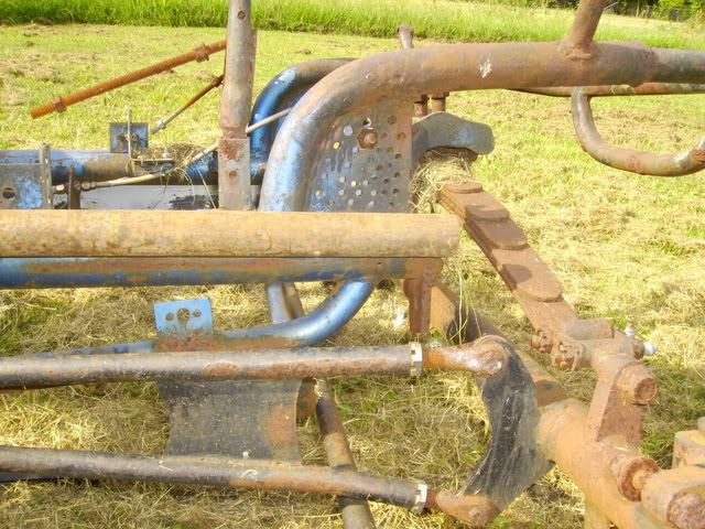

For some stupid reason I have a piece of pipe in this picture against the mainrail.

It looks like some sort of pivoting mount for the front of the rear radius rods. A pin welded to a plate, with the rods hooked to the ends of the plate, and the pin allowed to pivot in a bushing on the frame. Don't know if that is right or not, but that kind of thinking is what makes bringing these old warriors back to life, so cool. Thinking outside the box, and not afraid to try something different. Always another way to get the skin off the cat, if you just think about it for awhile.

There is a lot of similarities between my old car and this frame. If not the same car, it was built about the same time and probably by one of the OKC builders, Phil Hancock, Les Lusk, etc. They all did about the same things. Notice the bracing between frame and front bumper mount. Looks the same. Notice the dzus fastener plates between main rail @ front and bottom rail. I had a cover built that used dzus fasteners on bottom. One of your pictures looks like there is a cover on bottom of engine bay but it looks a little mashed. Very similar.
