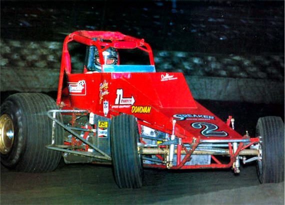

This is what I want mine to look like, when I grow up. LOL
