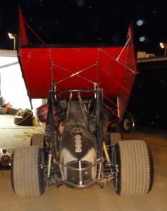

2016 SOD spec tires. 100/13-15 medium and 92/12.5-15 D15
Rear view
Tire set

This should be interesting. Loosing 5" off the right rear cir. and 3" in width. So right rear will be 2.5" lower. Going from probably a 88 or 90 to 92" cir. 2" in width. So loosing 12 to 14" of stagger to 8" of stagger.
Can't wait to see if this helps passing in the heats or is it the wing that is the problem.

Ok.  So are you only allowed these two tires?  Can you change stagger?  I understand the right rear, but not the left other than width.

There are not different sizes of LR so you will have to set up your car with the same stagger all night no matter the track conditions. Spoke with one of the drivers who did the test at Eldora and the lap times for a 360 and 410 were real close which means the narrow tires equal the playing field. You can have all the horsepower in the world but if you can't get it to the ground with the narrow tires you will be no faster. It will be interesting to see how this plays out in 2016 for SOD.

That may be the most beautiful pair of pics ever posted on this board. Would like to see at least one more option on LR size though.

I actually am really excited to see where this goes. The results show it levels the playing field. Agree with most above me, there needs to be a variety of sizes so teams still have the ability to change the stagger and set the car up different. That is part of racing and should stay.
Rear view
Tire set
personly I dont think narrow tires are the answer all together. Why make teams buy all NEW rear rims and tires. Why not try running harder compounds on both the left and right rear. No new rims to buy just tires, pluss the added benifit of tire that last longer. something harder than a d55 or d65, then you will see some racing.

There are a need to buy new wheels. For one the tire in the picture has the side walls waaaaay to wide , that tire is not recomended to go on a rim wider then 13" according to hoosier, furthermore any racer knows that you will not get any side bite with that combination. Plus the tire mounted on a narrow rim will be taller. Taller tire = less wheel spin. I dont think this series will take off , hell alot of the sod drivers I talked to are either running the nra or the great lakes region series, where will the cars come from?
