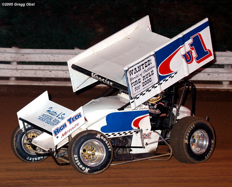

Would 410 sprint car racing be cheaper if it went to a smaller tire like the unlimited super late models did?
Dewease thinks the problem is easily solved. "The late models went through this years ago," Dewease said. "They had a big right rear and had all these wedges to put in the car, and it was too easy to go fast. We have the same problem. They went to a narrow tire and unhooked the cars and now, they have to race."
"That's what we need to do. The tires have gotten so good, that we need to go to a smaller tire."
- Lance Dewease
"I didn't see a big problem when we had to put on the 16" (wide right rear tire) for the ASCS show. I think 16" is a move in the right direction, but it plain and simply is not enough. The tire companies will probably freak out on this, but I believe we need to cut the left rear width back to around 12" to help take some of the drive out of the car. Less tire, less power needed." - Jeff Swindell
