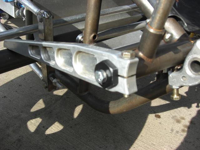

I would would like to see the stop that fell off and try to put it back on the bar without loosing the bolt and if it went on try to torque and if it torque good I wonder if the bolt threads got messed up to where it felt like it was torqued but was really tight.. Crazy things happen.. Why so many now.. Time will tell..

what i see as the biggest problem is that everyone is so concerned about weight that they have all gone to stops that do not have through pinch bolts with a nut on them anymore , they have aluminum stops or ti stops and the pinch bolt is just threaded into the bottom of the stop , when the pinch bolt went all the way through and had a nut on the bottom so that u could get torque on the bolt we almost never saw a stop come off . i think we need to go back to this before someone else gets killed , the insignificant amount of weight that a nut will add is well worth saving lives !!!!!!!!!!!!!!!!!!!!!!!!!!!!!!!!!
    The light weight sprint car parts deal has been going on for a very long time and will continue to do so.  The thing is it's not just rules but doing what makes sense.  I remember when I was on a sprint car crew and we ran syracuse in the early 90's and I remember standing on pit road during the final warmup for the sprint car event.  I was standing right next to Steve Kinser's car and I noticed how "they" drilled holes in the lapbelt hardware that fastens the belt around the frame and I stood there wondering how much those drill chips weighed when they were put on a scale?
     The torsion stop falling off the bar is nothing new but making the choice to not use a piece of threaded rod and two flat washers to hold the stop on is a light weight fix that some either forget during a "thrash" to get the car out or just don't use and then we see the fallout.

Someone enlighten me please!   I don't really know how a sprint car suspension works, my mechanical experience is on stock cars.   I found a couple of diagrams of torsion bar suspensions.  Looks like the torsion stop for the right front actually is on the left side of the car, opposite the side of the right front torsion arm?   I assume that if this fell off of the car, then the suspension would collapse?   Then the frame digs on that side and turns the car hard right?

We have witnessed this on the RF stop in the past as well.  We've been running 1/4" all thread and fender washers for about 3 yrs now, we also don't leave a much of a gap between stop/arm and torsion tube anymore.  The RF generally has little to no load on it and the problem is believed to be somewhat of a slide hammering effect of the rf bar and arm pulling itself out of the stop, this combined with grease on the splines not allowing the stop to actually clamp the bar itself tightly.

That is my thoughts exactly in a previous reply. If you never have tension on a moving part such as the rf stop & bar it does give it a sledge hammer effect every time it receives a snap effect because of lack of very little load on that corner. I personally witnessed Fast Freddie lose the rf  stop & bar 3 separate times in 1 night @Lincoln. Twice in the feature of which he was fortunate enough to win that evening!! The cause then was a local brand titanium stop.

The slide hammer theory has been discussed in these parts as well. As the right front loses it load during accelaration, a possible type of harmonics takes place, resulting in the whole bar assembly slapping back and forth and hammering the stop off. With the possibility of different brands and or materials of stops, arms, and splined bar sizes, resulting in less than desired clamping/retaining force, shit falls apart.
Yes, the new retainers as well as threaded rod should do there jobs. But like some other posts, it "IS" just a band-aid.

You are correct.  I am also thinking that as you go thru corner you car is winged down on left side.  As you  come out of corner it will settle more square and the stop comes off or stop was off before corner and since it was winged down on left it cornered ok.

When the stop comes off the bar and arm back out and jam the combo steering arm- locking the steering.

Due to the splines thereselves it doesn't allow for full and even 360* clamping load between the bar and arm/stop, this combined with the grease on the splines as I mentioned before results in what we see.  One solution would be to machine a groove in the bar and redesign the stop so the pinch bolt goes through this groove.  This is how all automotive OEM  splined pinch bolt style steering shafts are designed.   I wouldn't consider anything that keeps the stop from coming off a band aid, call it added security if you will.  Just like safety wire on certain bolts or drain plugs etc.
