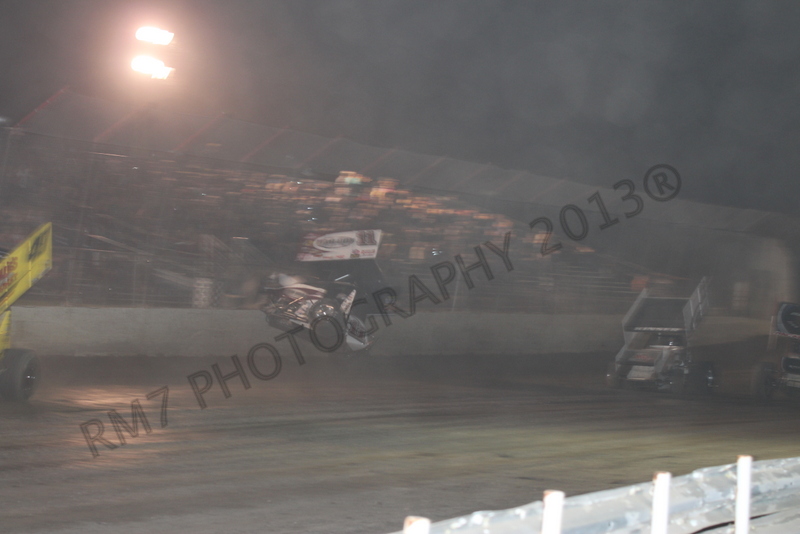

I know this is during hotlaps so was not completely up to speed so imagine the same wreck at probably another 20 mph+ or on a larger track with cement retaining wall this wall buckles and moves in the video.   we would have lost another driver this is as scarry of a wreck as I have ever seen. I have known and been friends with donny and his family for 20 years and even worked on his cars for a time way back when and they have always strive to have the safest well maintained equipment imagine a car and driver with less than the best equipment around.   I am sick to my stomach after watching that wreck. hoping good comes out of this just another big wake up call something has to be done. glad you are ok donny
I was at Castrol on the weekend taking photos and it was a very very scary wreck that's for sure I am glad it did not happen 10-15 feet farther around turn 4 or it would have been a solid concrete wall. As scary as that wreck is I think the wreck on Friday night involving Steve Kinser was just about as scary when he ended up going straight into the front stretch wall full throttle that completely destroyed his car. This is 1 of 14 photos and by far the worst clarity wise I got of Steves wreck which shows him going straight into the wall.
