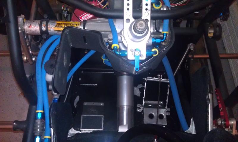

I ordered the part from KSE and did it my self. It was under $75 dollars. The GenII knee guard did not fit it so I made my own out of a Kirkey knee guard. I'll post a picture.

This is the one off the gear I just sold. I cut the right side off and put a hole in it for the short side. On the next one I'll post I didnt put the hole in the right side.

Posts: 204
With the Butlerbuilt seat it makes a big difference getting out of the car.

That looks good. I actually have that same Kirkey knee guard. I'll probably cut mine up and give that a try. Thanks.
