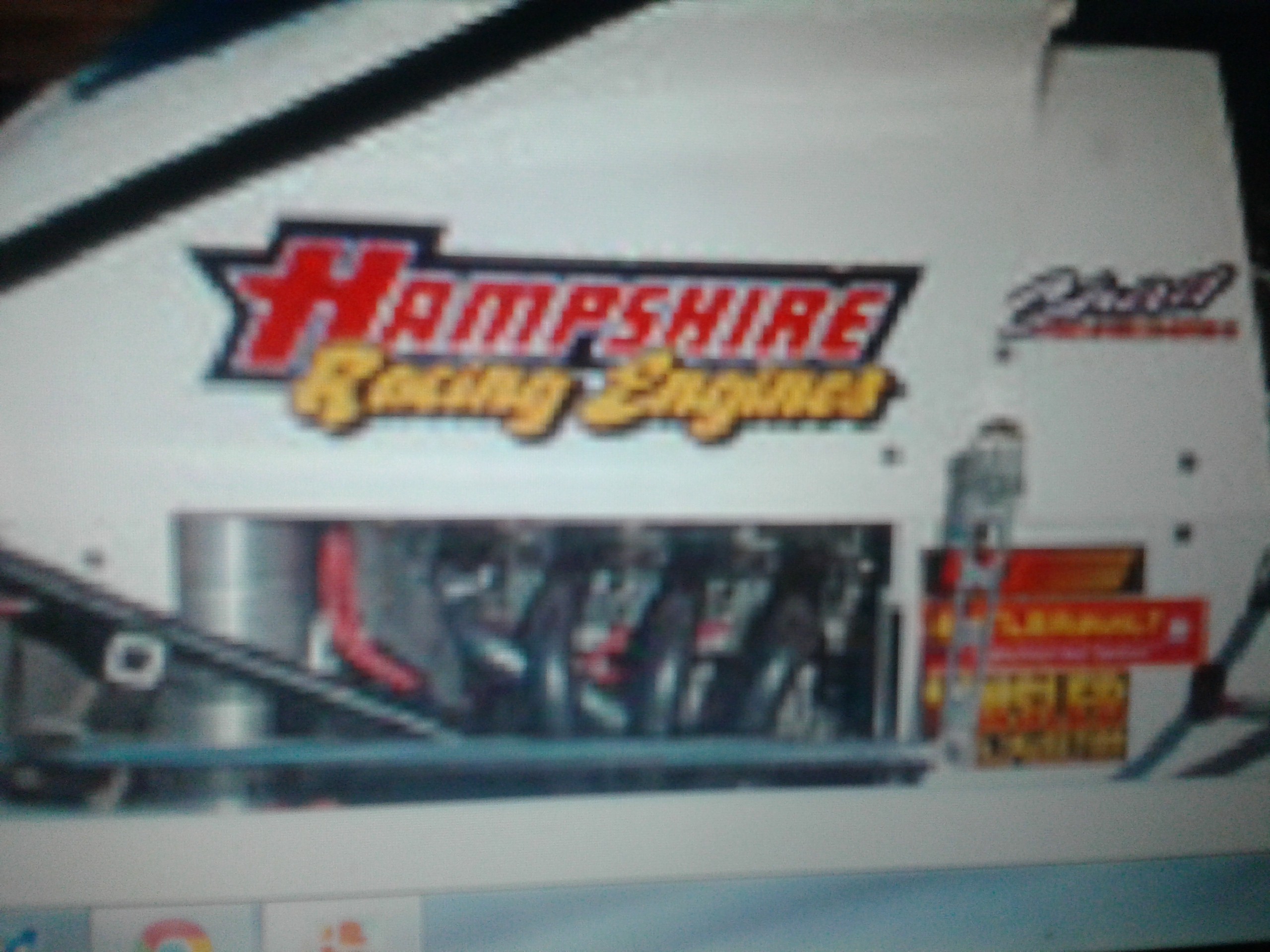

So are Sheldon's heads legal or do we look the other way since they are bolted to an sbc?
meatbag
May 14, 2014 at 09:47:22 PM
Joined: 07/10/2007
Posts: 947
Is that a LS engine?  Chad Kemenah had the same heads on at Nationals last year!

Posted By: meatbag on May 14 2014 at 09:47:22 PM
I dont believe the "Nationals" follows 100% WoO seasonal  rulebook. (alltho getting closer and closer)  better head design for the SBC has been out for years, the theory of a BBC head is (also) better,to which has been in use for many many years, as well as the basic design of Mopar And Ford, Thus Pontiac and others were investigated to deem a benifit,  Dont be fooled, if you have to open the hood on your 70 mustang to do a comparison, save yourself the time, intake runner,volume,valve angles,combustion chambers , are all extreemly different and massaged with one thing in mind , NOT driveability from point A to point B,this is full competition style engineering  for those wishing to pound on thier chest and point out the X brand from the A brand heads , feel free to do so i guess,  RnD on top engine builders has been exhausted to the rules requirements.. its just that simple.  sure theres something better, but, is it legal?
