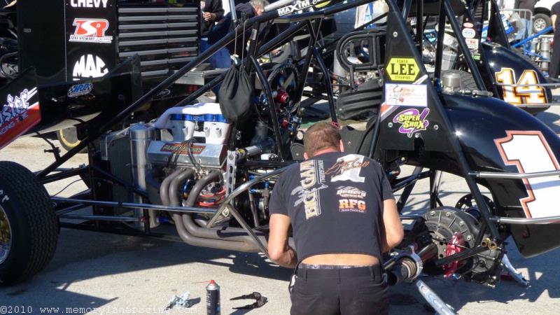

Posted By: vande77 on February 14 2011 at 01:34:33 PM
Sammy was using Parker motors I thought he said in victory lane....
I know this has been talked about a bit, but as an FYI, I snapped this pic Sun morning in the parking lot. Looks like Parker on the valve cover to me.
