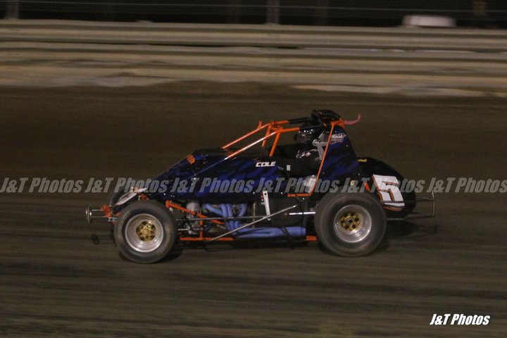

I am not that tall, but have an extremely tall upper body...when sitting down I am even with someone 6'4" - 6'5".
Buying a new/tall/big chassis wasn't in the cards for me financially, so I had some alterations done on a std. car. Seat bar moved down/lower, and also had a 4" halo added to the top. My knees are pretty close, but it gets the job done. I have no concerns with sitting a bit higher with the halo, and using a containment seat. Tony Beaber did the work, and did a great job. I may sell this car, and quite reasonably. I also have an 04 J&J frame/body with the same work done I'd sell.
