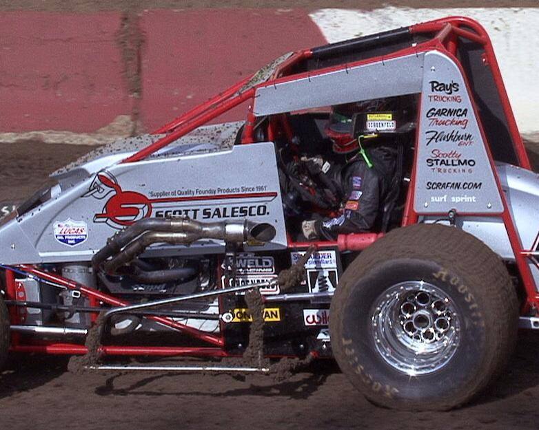

Damion Gardner at Perris in April

Damion Gardner had them on out west at Perris in april
I notice from the pictures of the Salute to Indy at Perris this past weekend, Damion had them on the car Saturday night also.

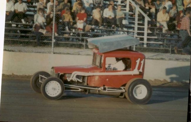

This is the type of headers I remember Sammy having one night at Knoxville for a WoO show. This is Ron Jackson's Super mod from the eary 70's at 34 Raceway in Burlington,Ia.

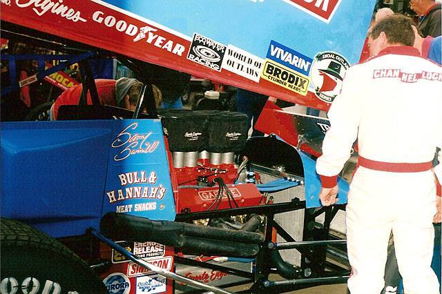

Sammy ran thoses back on the gambler channellock car

Posted By: oswald on May 28 2014 at 10:56:29 PM
I think it was when Sammy had the channel lock car he had headers simalar to those except they angled up more and went to the back of the cage. Don't think he ran them long but I know he had them at Knoxville at least once.
Damian has actually been running them for a few years now
He told me a few years back that he gets more power that way.
