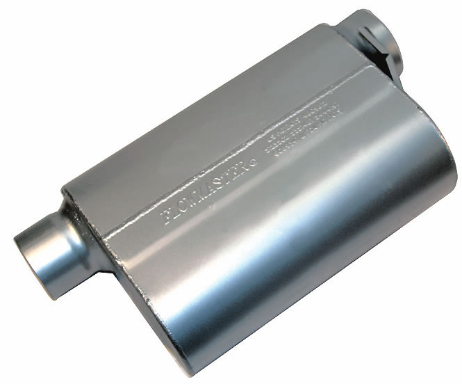

ALL USAC CRA, WESTERN CLASSIC & WEST COAST SPRINT RACERS NEED TO READ THIS.
I figured it was easier to just explain all this myself, instead of putting it in a press release. We are going to be going to several race tracks coming up very shortly, that have very strict noise restrictions.
Ventura is May 10th. You must be have one of the spec mufflers listed in their rules. I spoke to Jim Naylor and he will also allow the Flowmaster Suitcase muffler.
May 16th at Ocean is the strictest track. John Prentice had a long, expensive lawsuit because of noise at the track. Ocean Speedway now must be at 90 decibels @ 100 feet. That is 5 decibels quieter than last year. ALL cars at Ocean Speedway are now running the Flowmaster Suitcase part# 53545-10. If you run the Flowmaster Suitcase you have nothing to worry about. John tested several mufflers and that was the only muffler that meets the noise ordinance. If you show up with a different muffler and are over 90 decibels, you will not be allowed to compete.  There is no judgment call here. The state of California will be at the track checking decibels. If you have a question about this PLEASE call me. Do not question it on the Internet. Remember, just because you met the sound requirement last year at Ocean Speedway, does not mean you will meet it this year. It is now 5 decibels quieter.
We will also be going to Petaluma Speedway and Silver Dollar Speedway this year. Both tracks also have VERY strict noise restrictions. Both tracks basically have the same philosophy. If you show up with the Flowmaster Suitcase, based on experience and testing, they already know your car will be quiet enough. If you show up with a different muffler, you will be under the microscope and be checked by the decibel meter each time you are on the track. If you do not meet the sound requirement, you will be disqualified.
You guys can get upset if you want, but we are backed in a corner and there isn't much we can do about it. This isn't going to go away. It will only get more strict. The Lawsuit at Ocean Speedway has set the bar for noise in California.

Ventura Speedway approved mufflers
Extreme #6014-3530 & 3615-3535
Coastal Fabrication #350x625x17-2sVRA
Spintech #180 Degree & 1545P Super Stock series
B&B Performance #FRAC-0375-S, 180 degree, with side outlet
Flowmaster Suitcase #53545-10
Ocean Speedway, Petaluma Speedway, Silver Dollar Speedway approved muffler
Basically the moral of this story is that if you have the Flowmaster Suitcase you will be legal. You may show up with whatever muffler you want, but it is at your own risk that you will or will not meet the sound requirements.
