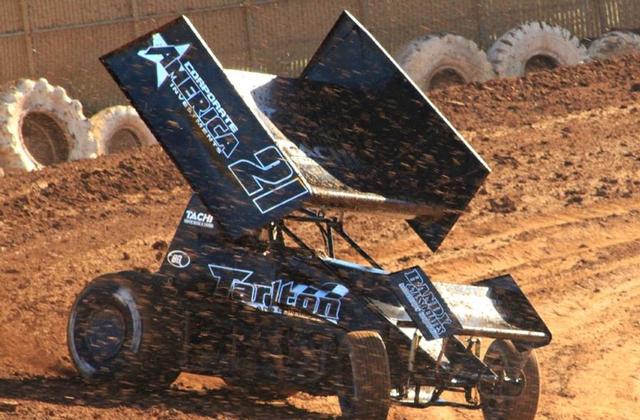

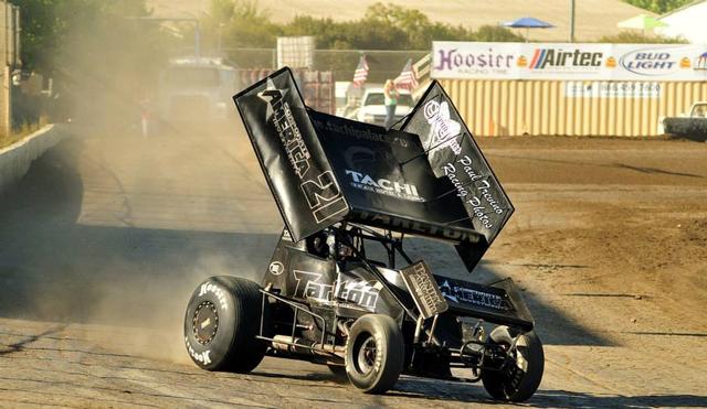

I noticed that Tarlton's right side board on the top wing is mounted and shaped differently than most any other wing I've ever seen.  Does it give him any advantage?  Does anyone else use a similar wing?  Do the rules limit anything on the wing other than overall size, dished/non-dished, wickerbill or mounting points?

Nice to see someone trying something different. Looks like it favors running the bottom as more air should catch both panels.

Not legal to run with the WoO or any major sanctioning body, Lasoski showed up to Knoxville years ago in the Beef Packers car with something similiar, it was the only night he got to run it before it was outlawed, there are many rules on the wings as far as WoO or Knoxville or similar track/series.

Most race sanctioning bodies have a rule of the angle of the corners, with a margin (+/-) degrees that you must be within. I doubt anybody is really looking though.

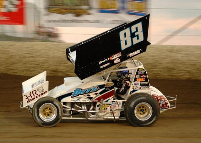

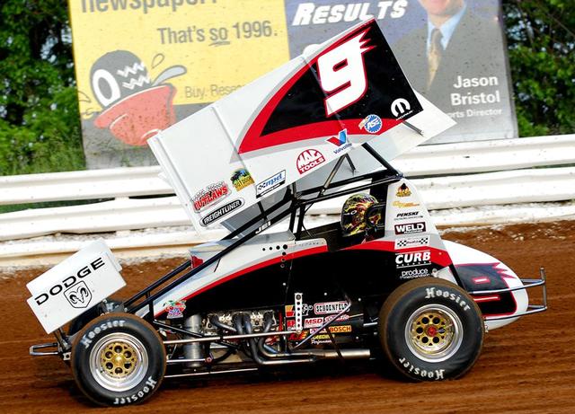

kylenap
April 14, 2014 at 11:54:59 PM
Joined: 02/08/2005
Posts: 534
kylenap
April 14, 2014 at 11:58:18 PM
Joined: 02/08/2005
Posts: 534
kylenap
April 14, 2014 at 11:58:49 PM
Joined: 02/08/2005
Posts: 534
Those were some of the weird top wing designs in the past eight years.
