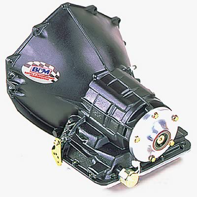

Here's a pic of a Ford tranny. Does any company make this "small bellhousing" for a powerglide ? I did not see one on the TCI site. What covers the converter on this one ?
This would help a lot !

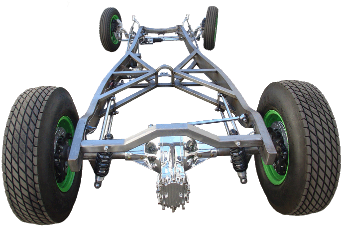

Winter's IRS
427HISS
June 14, 2007 at 05:14:30 PM
Joined: 04/19/2007
Posts: 33
Installed
