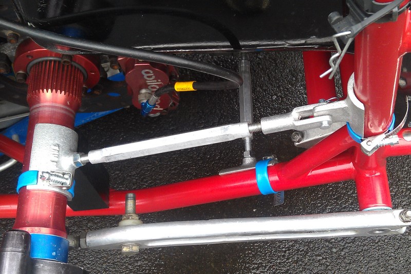

The company is called Tru Square and the tool can be ordered direct at 360 878-2918 or from your local speed shop. The tool is used to move the rear end into place (proper distance from motor plate, squared, centered, etc.) then it hold it in place while you time birdcages and hookup the rods and arms. No more falling off the blocks , no more straps, no more cussing. Also with the rear end held securely in place you can work on other parts of the car at the same time.

Nice looking piece. Eveyone will make one know. Wasn't try to be negative, but most birdcages have a level built in. Great set up for the first timers.

I've been squaring Midgets for years & this is by far the easiest way I have found to do it. No shaking or falling off the blocks. Put it up on blocks, square it, time your Bird Cages & adjust the radius rods & torsion arm heims. It easily cuts the time in half. Very simple & easy to use...and IT WORKS!
