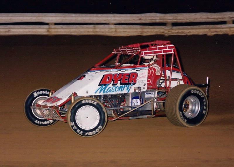

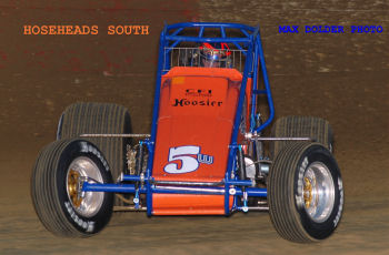

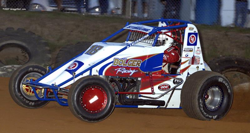

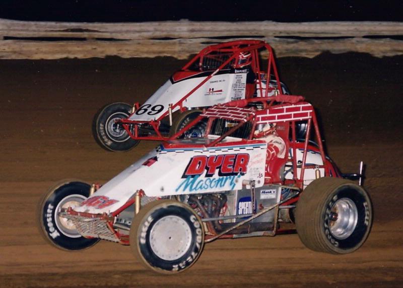

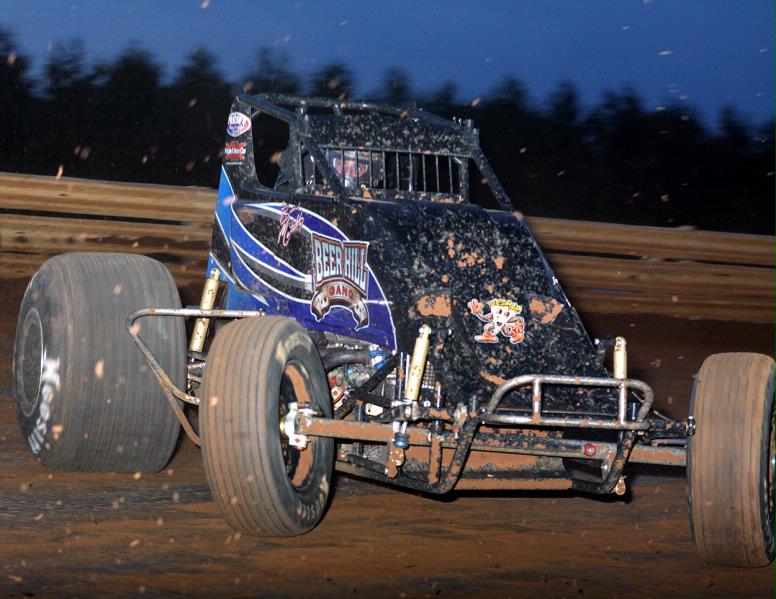

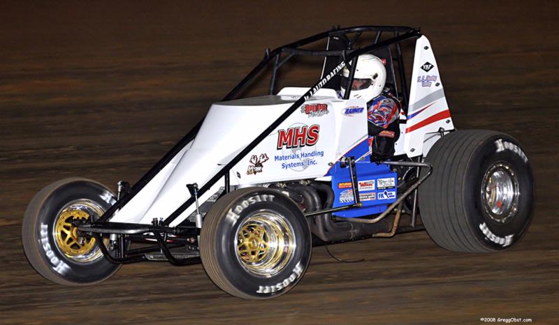

Here are a few PA guys who ran the Eastern USAC swing. All are winged cars switched over.

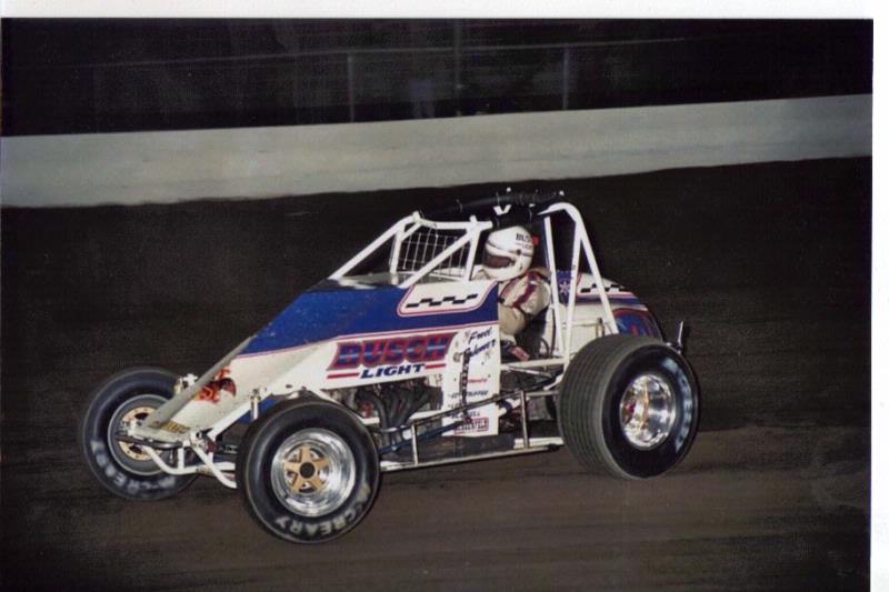

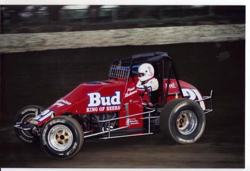

Fred Rahmer
Lance Dewease
