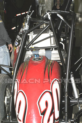

I was thinking the other day; sprint car chassis' haven't really changed in the past 15 years.
It's time for a change.
Almost everything on a sprint car has gotten better/lighter/ faster - improved over the last 15 years except for the chassis. Probably the biggest change to a chassis has been the addition of the optional safety bars to them.
Think about it, the brakes are better, thus alowing you to go faster. The motors are better, tires are way better. Hell, guys are still breaking records on spec tires.
Guys are wearing head & neck restraints and full containment seats. This is a good idea, but what good is it if your CAGE COLLAPSES?
I don't remember the last time I heard about a cage coming down on a guy in NASCAR. It shouldn't be happening in sprint cars either.
Here are a few photos from just this season already. One is Chad Humston's car and the other is TK's from Knoxville.

Here's a picture (I hope it works) of some kind of frame I found while looking on ebay. It reminds me of a funny car or pro-stock drag car that has a "cage within a cage" I had never seen anything quite like this, it may be a step in the right direction?? Sprint cars are probably the most dangerous dirt racing next to flat track motorcycles, but hopefully there wont have to be another tragic crash to get people to start thinking and keep developing.

slow_sprinter, I believe Charlie Fisher had a design very similar to that quite a few years ago if my memory serves me right. Next time I talk to him I'd like to ask him why he abanded it.
Wonder why more people didn't do the same?............ Oh wait a minute, extra tubing means extra weight. Silly me

I beleive Chris Schmelze from Canada races a chassis very similar to the one pictured. I am not positive but at the Nationals last year I noticed his car had that type of look to it. On ascsracing.com Chris's chassis is listed as a lejeune, which I have never heard of.
I was at I-80 for Chad Humstoms wreck and no matter how thick that chassis tubing would have been, or what brand of chassis, his cage would still look like it did.

Hawker, we shouldn't be seing stuff like that! Yes, I know sprint cars and their drivers are rough & tumble, but I've been around a lot of dirt tracks that race all kinds of classes, and mostly sprint cars are the ones you see that have cages break.
I've had cars with safety bars, and I didn't really care for them. They did take some chassis flex out and were hard to get in and out of.
Knoxville rules are 1 1/2" x .095 tubing for the top rails (down tubes and sides of cage). I would have to think that if they were made of 1 5/8 or .120 that they would be quite a bit stronger.
Someone said Humston was t-boned and that's why the cage broke. I still say it shouldn't be that way. Nascar guys get hit ate 200 and the cages are intact. Indy cars get hit at 200 and yes, the monocoque may get separated from the rest of the car, but it stays intact. And it's made of carbon fiber!
When I see some of these cars I have to think these guys are ultra lucky, or Jesus goes to the races too!
Basically, what I am trying to say in this thread is we have improved EVERYTHING on a sprint car over the last 15 years except the part that really matters; the cage. The cars are going faster than they ever have and the cages haven't gotten any better. Make sense to you?
20 years from now will we be wondering what on earth we were thinking using .095 tubing to keep guys alive?
