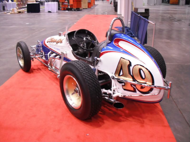

KIEHOLTZFINALDONE039.jpg picture by brian26_photos_2007

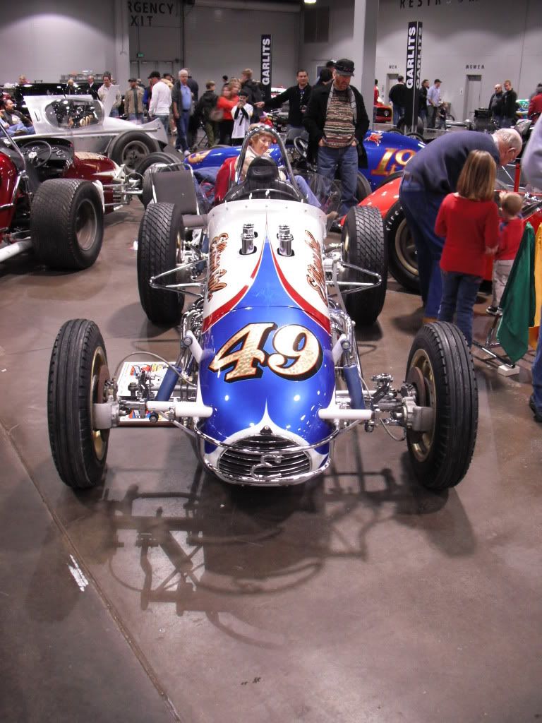

KIEHOLTZFINALDONE028.jpg picture by brian26_photos_2007

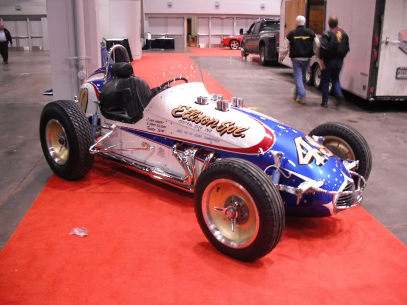

KIEHOLTZFINALDONE038.jpg picture by brian26_photos_2007

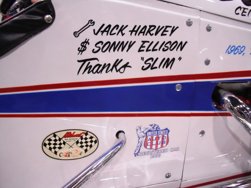

KIEHOLTZFINALDONE032.jpg picture by brian26_photos_2007

Posted By: brian26 on January 11 2010 at 09:08:56 AM
Very nice looking car. They attended to detail on this one. Nice color scheme. ..Luther

Posted By: brian26 on January 11 2010 at 09:09:31 AM
This is one of the few 4 bar cars that has the front torison arms shackled to the front axle. The only builder I know mounted them that way was Floyd Trevis. ....Luther
txracinfireman
January 12, 2010 at 05:11:42 PM
Joined: 09/30/2008
Posts: 74
Posted By: Sprint97 on January 12 2010 at 01:11:43 PM
Jim McElreath also did that.
January 12, 2010 at 07:04:38 PM
Posts: 7918
Edmunds did too for a time.
Sprint97
January 13, 2010 at 09:20:18 AM
Joined: 03/19/2007
Posts: 253
The schackle type mount would be an easy way to change the rake of the chasis by changing the length of the schackle. You would have to consider the location of the front torison bar tubes as far as height to accommodate the schackles. I saw a champ dirt car that had small rollers for the torison arms to ride on. The rollers had small heigth adjustmrnts. ...Luther
