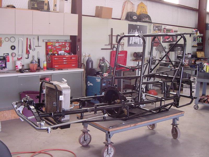

This is a spring front Parson frame built in 1973.

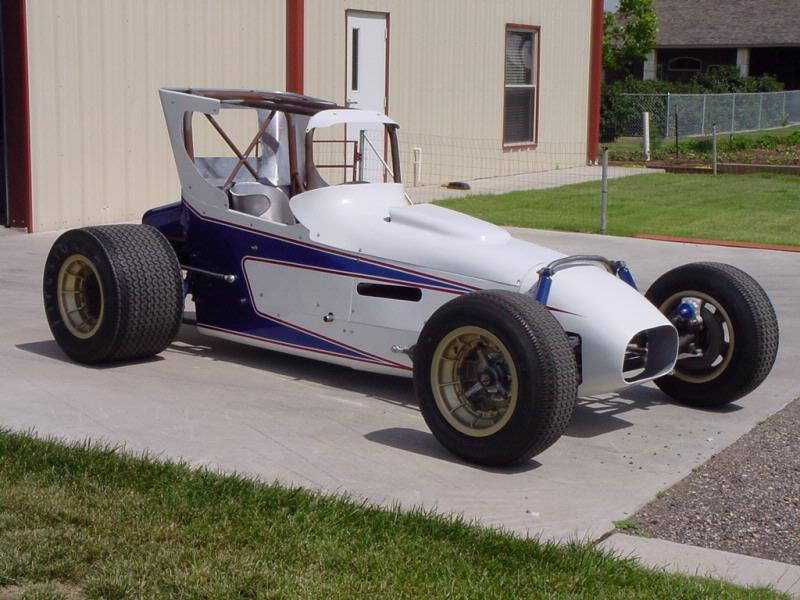

1973 Parson with body.

How about this....some pictures of the different frames so I might look at them to see if I can see any differences. After all is it not the goal of this forum to preserve these fantastic machines and the era, For the future and pass them on to new and young fans. I am just tring to understand an learn about these supermodified race cars. Thanks

roostasix.....thanks,
When I was writing the above post yours was not yet up for me.
Outstanding race car....Thank you

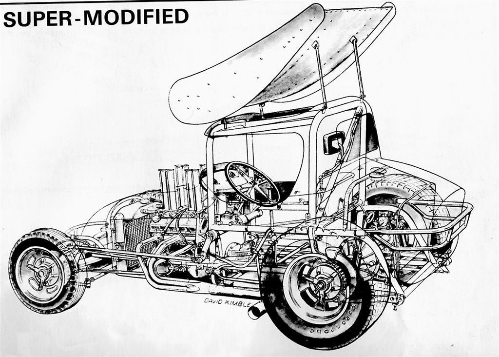

86" wheelbase Edmunds.
Truth is although Edmunds didn't invent the super, he is widely credited with the design.
edmunds_41-1.jpg picture by brian26_photos_2007
