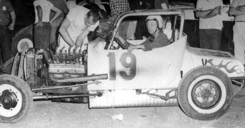

I am looking for any old pictures or info on the Jerry Gilbert #19 T Roadster from Lee's Summit, MO. I would like to replicate this car. My dad, Ken Jackson, worked on this car and ran his on B modified (Purple and White #42) at Olympic Stadium, Lakeside, Riverside, Sedalia, Marshall, Knoxville, etc. I was around it as a kid, but memory has faded. My dad died in 1987.
I have some pictures from High Plains Thunder, the internet and one at home from a victory at Sedalia. I am told Luther Brewer or Curt Grogan might be able to help.
Looks like the car ran a 327 SBC with 4x2 Stromberg 97s. I already have some vintage parts. Any help would be appreciated. A great era in racing. Thanks

I might have a picture or 2 of the car. I saw it run severa times. My car competed in the same races. It did have a small block Chev, likely a 327 since it was early 60s. It had a car frame, I heard a 29 Chev, with a Ford cross spring rear with a housing quick change. Ran wide 5 wide bolt pattern wheels ( the 36/39 Ford pattern) and was a T bucket. Jud Larson & Gordon Woolley were the drivers I remember in it. I was in Jerry Gilbert's garage in Lee's Summit on Old 50 Hwy before it was replaced with the 4 lane highway. It was located about where the parking lot is in the shopping center near John Knox Village. The pictures I have are likely newspaper clippings.
In fact the 3 rd car I built was a 29 Chev frame with Ford cross springs front & rear. It was an attempt to have a car that handled like the #19. If I have any information or pictures, I will let you know through this thread & send copies.
Good Luck, Luther Brewer

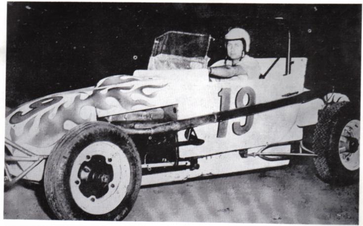

Here's a couple I have of the 19.
Curt Grogan

Curt, thanks for the pictures. The first one with the hood and nose off is especially helpful for some of the details I needed. I really do appreciate your help.

Great pictures. Appears to be Wes Farrand under the wheel (at a younger age). It does have 4 Stromberg carbs. They could be 97s or 48s. There are still some of those around & they are easy to work on.

Both shots are of Gordon Wolley
Curt Grogan

Luther, do you know what type of radiator is shown in the picture posted by Curt Grogan? Also, I learned from two different sources that the car actually ran with a fiberglass body...not steel. As I guessed, Jerry shortened and narrowed the frame. There are still things I am trying to figure out how it was fabricated. As someone told me, think about what he would have done with a drill press, grinder, gas and arc welder and a cutting torch! John Layne told me correctly that once you gather the parts, you need to figure out how they all went together. He has done some great restorations (Greg Weld's roadster, Joe Saldana's roadster and the black #3 Wes Farrand sprint car).

I dont know what radiator the #19 had. I also was not aware it had a fiberglass body. A suggestion on the wheelbase. Take a picture to Kinko & have a 11 X 17 copy made. From the copy, you measure the wheels & convert that to a scale. Then use the scale on measuring every part; roll bars (width & heigth), wheelbase, hood heigth & any measurement you need. Get a large piece of graph paper to draw the car on before you start. That will help you build a close duplicate.

I continue to work on replicating the Jerry Gilbert #19 T roadster. I have a few questions some of you mechanical veterans of this era might be able to answer:
Anyone have any idea what type of steering box would have been used in the t-roadster pictured above? (I doubt it was a Schroeder!).
Also, relative to the question above, I do believe the radiator was a 1959-60 corvette.
I believe the rear axle shafts are from a 1939 Ford one-ton truck. One picture I have shows an alumnium brake hub (Safety Racing, Eau Claire, Michigan...like what is on the rear) mounted on the right front and an axle shaft cover like what is on the rear. Any idea how this was done on the right front?
Any other pictures anyone has would be appreciated. The ones listed by Curt have been very helpful.

KC Race Fan,....I think the method used to place a 3/4 ton truck hub on the right front was to machine the hub smooth on the back of the brake mounting flange. You would want to machine that surface to fit the surface it is to bolt-on to. That is, if there is a protruding ring, machine to fit that surface. Then bolt the hub through the backing plate holes to the car spindle through the backing plate holes. The holes should match. If they do not match, weld it to the car spindle.
The steering may be a Ross. They were popular at that time. I used Ross on 2 cars. They were on self propelled combines & other industrial machinery. Some even had a long shaft out the side.
On rear pickup axle shafts, look around. I think on some models, one axle was shorter than the other. I do know there were different lengths. On the 10 th car I built the owner wanted to install truck housings and axles. We used the shorter ones. I also did that on car #4 (CAE Chasis). .............................Hope this helps,.....Luther

I'm betting a Ross steering as well. They were also on forklifts back in those days. Ross was a giant in steering mechanisms, and there were so many models, yet one that works for these cars is hard to find these days.
Tested and proven, Ross steering boxes were stronger than Schroeders, and today have more credibility(restorationwise) in my opinion than a Schroeder outside of Indy Roadsters. If you know of anybody that messes with old forklifts, 40 years old thereabouts, hit them up. Parts are hard to get last I heard.
Bob Higman told me he used them and only those boxes. The money you saved could go elsewhere and the box was not bulletproof, but then he never broke one either. Higman fielded midgets and sprints for many years with USAC and also was the mechanic along with AJ Watson and Norm Hall that put JC Agajanians old Kuzma roadster into the 500 in '60. Aggie traded it in for a new Watson for Lloyd Ruby to drive, which according to Donald Davidson IMS Historian, became the blue and white Old Calhoun #98, 1963 winner. Some say no, but I'm not arguing with Donald. Besides, Aggie was too cheap to buy a new car every year.
Since I talked to Higman, everything he said has turned out to be true or ended up making a lot of sense.
