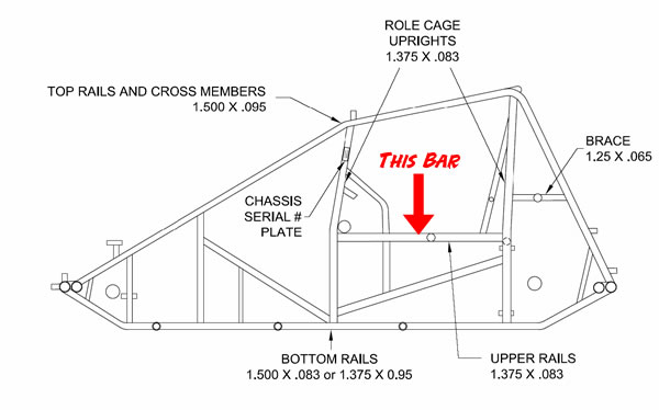

Here is what I know.
Below is a image of the frame spec from the rule book.
The bar that is labeled "This Bar" was .065 on all the kpc chassis. The rule specifically states that the bar is suppose to be .083. I was told that they were allowed to run because the manufacturer did not mean to use .065 on that bar. They also said that it was not a performance enhancing modification.

Posted By: BigDog on August 12 2008 at 08:00:24 AM
Did not mean to use .065 on that bar...lol? :roflmao:
But then again, judging by that diagram everyone is running their front axles in the wrong spot as well...lol. :laughing7:

One thing that you folks seem to be missing. Nowhere did I see that the listed wall thicknesses are REQUIRED, so no rules were broken.
Per the Knoxville rules:
*CHASSIS – Any sprint chassis is allowed, but it must pass any test prescribed by the safety inspectors. The roll cage must be of a four-post design. Sprint cars only – no dirt champ cars please. Wheel base no less then 83” and no more then 90”. No elliptical tubing used on or as part of the main frame structure. The following measurements are minimum: suggested material: 4130 normalized.
· TOP RAILS: 11/2" x .095
· BOTTOM RAILS: 13/8" x .095 or 11/2" x .083· ROLL CAGE UPRIGHTS: 13/8" x .083· ROLL CAGE TOP CROSS MEMBERS: 11/2" x .095· UPPER RAILS: 13/8" x .083· REAR END SAFETY BAR (mandatory): 1" x .083 or 11/4" x .065· BRACE: 11/4" x .065
