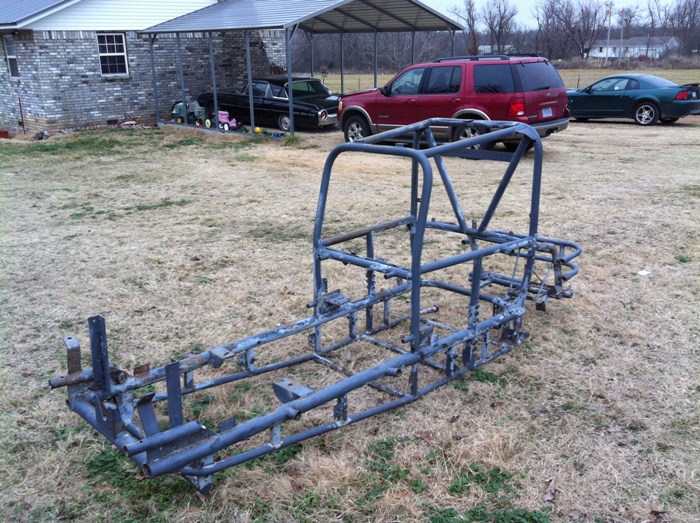

I've got about a 70-71 modified frame and it had the torsion rear end setup. Looking for info, instructions, and even pictures about this setup. I'm not that familiar with this setup and I would appriciate any help to get this modified back on the track in the future!
Thanks in advance!!

Red Racer 9
March 21, 2013 at 08:52:47 PM
Joined: 07/13/2011
Posts: 243
Thanks Brian, you've given me plenty to digest and to look for!! For those interested, this is the frame I've got to build on and a Vicki body in the shop if I decide to go that route..

March 21, 2013 at 09:21:12 PM
Posts: 7918
Posted By: Red Racer 9 on March 21 2013 at 08:52:47 PM
You'll want a 1/4" plate for a firewall/motorplate. I have seen 3/16ths used a lot though. There are people that can machine it easy, but if you're a poorboy likes me, a good drillpress,jigsaw, attention to detail, a little luck you can cut one out for yourself.
I'm very sure an early 70's Nance motorplate will fit in there easy or at least give you the very pattern you need. r get you close enough to make small changes.
If you use magnesium, go easy on the heat, the dust from cutting out the outside, flywheel opening, and drilling,can catch on fire if you get too hot after a lot of dust buildup.Yes, it's happened. Keep that clean and always check your measurements. Then recheck them.
March 21, 2013 at 09:29:47 PM
Posts: 7918
I sure did like that frame, the bones are right for an old Nance 3 window body or a sedan style. But I got the Suchy 76 and I needed room.
May not be much to many, but it looked good to me. I know it will handle well enough too when it's finished. You can also put coilovers on the front pretty easy if you want to get around the springer type suspension. But then you can also extend the shock towers out and make it a 4 bar as well. But that ruins the looks of the car , many think.
